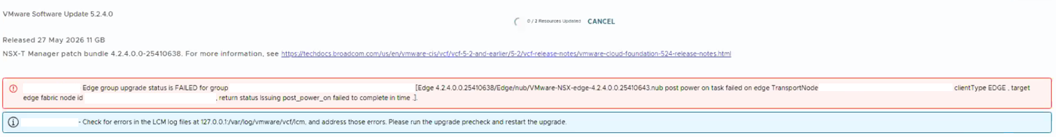

Edge group upgrade status is FAILED for group <UUID> <GROUP NAME> : [Edge 4.2.4.0.0.25410638/Edge/nub/VMware-NSX-edge-4.2.4.0.0.25410643.nub post power on task failed on edge TransportNode <UUID>: clientType EDGE . targetedge fabric node id <UUID>, return status Issuing post_power_on failed to complete in time
Upgrade Agent on Edge node <UUID> is unreachable. Restart the Upgrade agent service and check network connectivity.Management plane connection status of the edge transport node <UUID> is DOWN.Cannot upgrade edge node <UUID> , has errors Errors = [{"moduleName":"upgrade-coordinator","errorCode":30249,"errorMessage":"Upgrade Agent on Edge node <UUID> is unreachable. Restart the Upgrade agent service and check network connectivity."}, {"moduleName":"upgrade-coordinator","errorCode":30205,"errorMessage":"Management plane connection status of the edge transport node <UUID> is DOWN."}, ] .

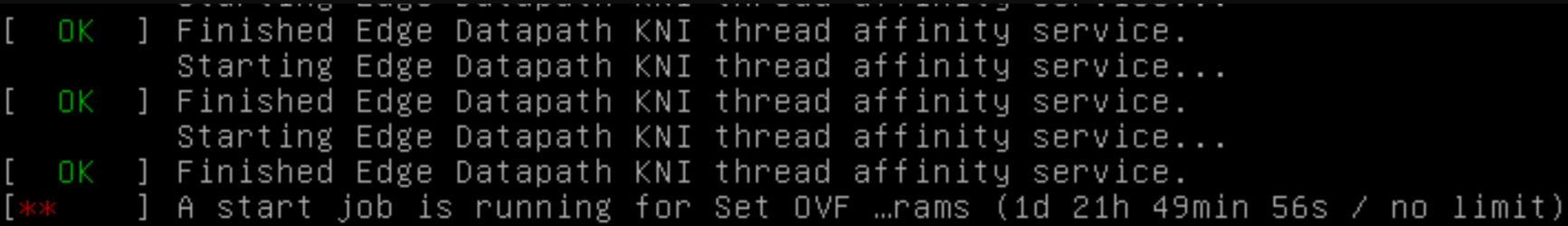

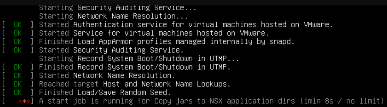

<DATE>T10:14:17.331Z ERROR task-executor-24-1-workitem-EDGE-<UUID> EdgeNodeUpgradeServiceImpl 879798 SYSTEM [nsx@6876 comp="nsx-manager" errorCode="MP30290" level="ERROR" subcomp="upgrade-coordinator"] Edge 4.2.4.0.0.25410638/Edge/nub/VMware-NSX-edge-4.2.4.0.0.25410643.nub post power on task failed on edge TransportNode <UUID>: clientType EDGE , target edge fabric node id <UUID>, return status Issuing post_power_on failed to complete in time .com.vmware.nsx.management.upgrade.exceptions.UpgradeAgentMessagingServiceException: Issuing post_power_on failed to complete in timeA start job is running for Copy jars to NSX application dirsA start job is running for Set OVF ... ramsVMware NSX 4.2.4 (VCF 5.2.4)
NSX 4.2.4 appliances require the RDSEED CPU instruction set to function. If this feature is missing from the underlying physical server's hardware or is masked by a legacy vSphere Enhanced vMotion Capability (EVC) cluster baseline, the appliance cannot boot properly. This issue can impact upgrade and install.
