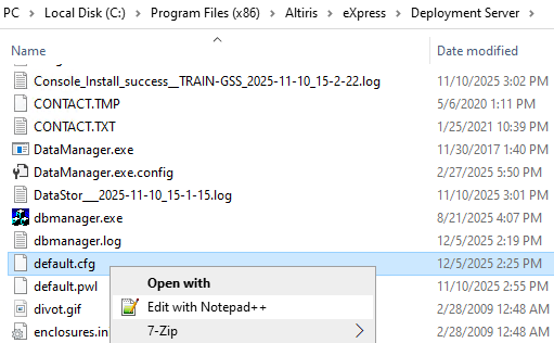

Step 4: Open File Explorer and navigate to the root of the eXpress share. By default the share is mapped to 'C:\Program Files (x86)\Altiris\eXpress\Deployment Server'
Step 5: Make a backup of 'default.cfg' file located in the eXpress share and save it in a different directory
Step 6: Open 'default.cfg' with a text editor (may need to run a text editor as administrator, then open the file)

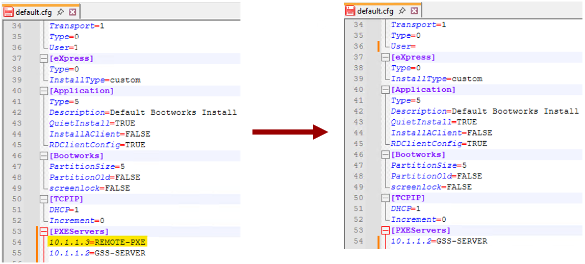

Step 7: Scroll to the bottom of the .cfg file and find the section labeled '[PXEServers]'
Step 8: Remove unused servers by deleting the entry. Once desired entries are deleted, remove any blank lines left behind. Keep each PXE server entry on a separate line. Save and close the .cfg file
