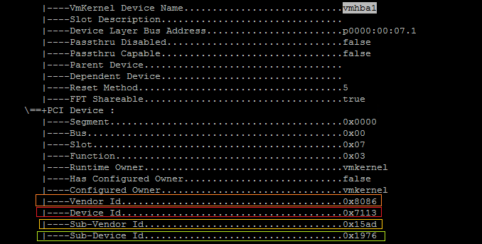

  • Alternatively, you could fetch the same information by running this command:
    • esxcfg-info | less
    • Search for vmhbaX by entering "/vmhbaX" where X is the number.
  • Upon hitting enter, you would initiate a forward search and result would be show as below:
