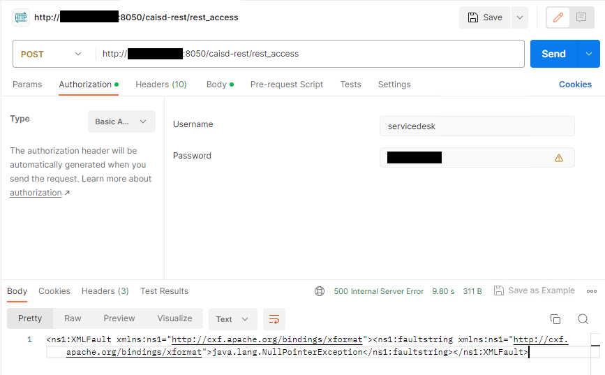

When we send a POST request from Postman to "http://<SDM_Server>:8050/caisd-rest/rest_access" by following steps on the knowledge document "How to test CA Service Desk Manager REST Web Service functions by using Postman" and SDM document, the following error message is returned and fails to send the POST request by using Basic Authentication.
<ns1:XMLFault xmlns:ns1="http://cxf.apache.org/bindings/xformat"><ns1:faultstring xmlns:ns1="http;//cxf.apache.org/bindings/xformat">java.lang.NullPointerException</ns1:faultstring></ns1:XMLFault>
