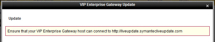

VIP Enterprise Gateway LiveUpdate fails with error: Ensure that your VIP Enterprise Gateway host can connect to http://liveupdate.symantecliveupdate.com

VIP Enterprise Gateway version 9.10.1 and earlier is configured to connect to the LiveUpdate servers on HTTP Port 80. If this port is blocked, the process fails with error Ensure that your VIP Enterprise Gateway host can connect to http://liveupdate.symantecliveupdate.com
VIP Enterprise Gateway version 9.10.2 and later is configured to connect to the LiveUpdate servers on HTTPS Port 443. If a proxy is in use, the same error can occur.
