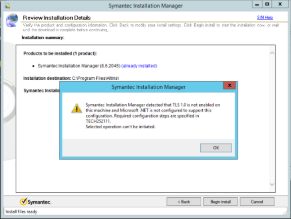

When applying a license in Symantec Installation Manager (SIM) the following error is seen:
Symantec Installation Manager detected that TLS1.0 is not enabled on this machine and Microsoft .NET is not configured to support this configuration.
Required configuration steps are specified in TECH272111.
Selected operation can't be initiated.
ITMS 8.x
TLS was improperly configured for the operating system in the registry.

The RESOLUTION is to check the following registry keys to verify that they are set correctly and then stop & start SIM again.  Here are the steps:
  1. Add (or modify if these already exist) the following registry keys with the specified values (save to .reg file and execute, if desired):
    a. Windows Registry Editor Version 5.00
    [HKEY_LOCAL_MACHINE\SOFTWARE\WOW6432Node\Microsoft\.NETFramework\v2.0.50727]
    "SystemDefaultTlsVersions"=dword:00000001
    "SchUseStrongCrypto"=dword:00000001
    [HKEY_LOCAL_MACHINE\SOFTWARE\WOW6432Node\Microsoft\.NETFramework\v4.0.30319]
    [HKEY_LOCAL_MACHINE\SOFTWARE\Microsoft\.NETFramework\v2.0.50727]
    [HKEY_LOCAL_MACHINE\SOFTWARE\Microsoft\.NETFramework\v4.0.30319]
  2. Restart SIM.
  3. Try to install it again.
