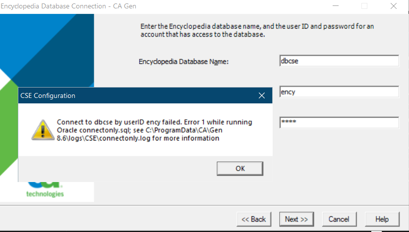

Running the CSE Configuration program (cse_config.exe) and the Encyclopedia Database Connection fails with "Error 1 while running Oracle connectonly.sql":
The corresponding log file C:\ProgramData\CA\Gen 8.6\logs\CSE\connectonly.log shows:
Run CSE Oracle command file Connect.sql on database dbcse for user ency
SQL*Plus: Release 19.0.0.0.0 - Production on Wed May 5 02:42:29 2021
Version 19.3.0.0.0
Copyright (c) 1982, 2019, Oracle.  All rights reserved.
ERROR:
ORA-12560: TNS:protocol adapter error

The reported error "Error 1 while running Oracle connectonly.sql" here is due to the fact that the 32-bit version of sqlplus.exe is being picked up first from the PATH but cannot connect to the database using the simple userid/password syntax and must include the @net_service_name in the connection string syntax.

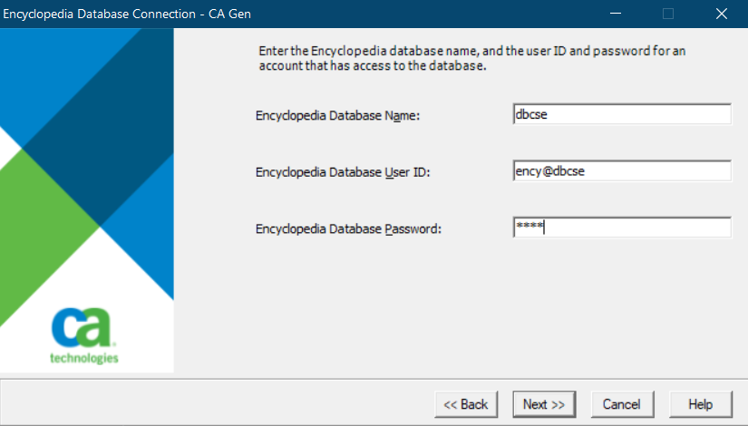

2. Then to resolve the connection error, use that Oracle Net Service Name in the User ID field with syntax userid@net_service_name e.g. for the above example DBCSE use ency@dbcse (NOTE: the Oracle Net Service Name is case-independent)
The corresponding log file C:\ProgramData\CA\Gen 8.6\logs\CSE\connectonly.log will then show:
Run CSE Oracle command file Connect.sql on database dbcse for user ency@dbcse
SQL*Plus: Release 19.0.0.0.0 - Production on Wed May 5 03:41:06 2021
Version 19.3.0.0.0
Connected.
Disconnected from Oracle Database 19c Enterprise Edition Release 19.0.0.0.0 - Production
Version 19.3.0.0.0
