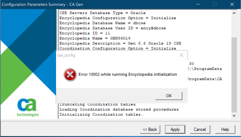

2. Typical problem if 32-bit ...\network\admin\tnsnames.ora file does not include the Oracle NET Service Name:
During the CSE configuration steps for initialization of the tables, 32-bit programs are used (initdir.exe and initdb.exe) which will automatically read the Oracle 32-bit ...\network\admin\tnsnames.ora file to get the Oracle NET Service Name definition. If that Service Name is not correctly defined in that file then during the first initialization step "Initializing Coordination tables" the error "Error 10002 while running Encyclopedia initialization" will occur:
