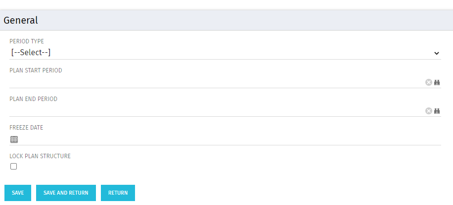

Option 2. Set the value at the Object attribute level
Change the Period Type in the above steps to [--Select--] for all entities. See Screen shot below
  • If this section is blank (Set to [--Select--]), plan period types use the default in the object attribute default value section.
  • If this section is populated, then the object attribute defaults are overwritten by the value set at the Entity level
