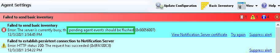

Step 4: Validate that agents are being rejected by sending Basic Inventory from an (SMP) Agent UI:
Note:
In the Agent logs you should see a log entry like these ones:
Failed to send basic inventory, COM error: The server is currently busy, the pending agent events should be flushed (0x80056007)
