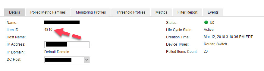

First, you need to obtain the interface ID for the interface you would like to modify and for that, you need to obtain the parent device ID.  Let us start in the NetOps Portal GUI under Administration -> Monitored Devices.  Find your target device and access the details page where you can find the device's Item ID:

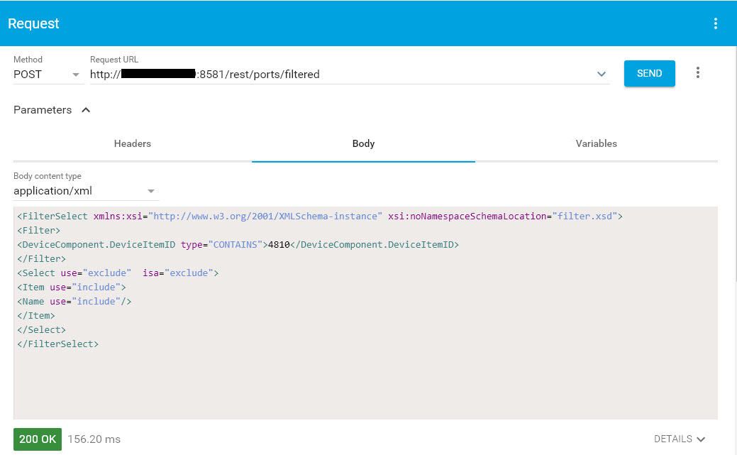

Take this ID to your chosen REST client and issue the following POST to get all interfaces for the selected device:
Method: POST
URL: http://daHostname:8581/rest/ports/filtered  (If FA DA: http://ProxyHostname:8581/rest/ports/filtered)
Body content type: application/xml
Body:
<FilterSelect xmlns:xsi="http://www.w3.org/2001/XMLSchema-instance" xsi:noNamespaceSchemaLocation="filter.xsd">
<Filter>
<DeviceComponent.DeviceItemID type="CONTAINS">4810</DeviceComponent.DeviceItemID>
</Filter>
<Select use="exclude" isa="exclude">
<Item use="include">
<Name use="include"/>
</Item>
</Select>
</FilterSelect>
For example, using a parent device of 4810 in the Advanced Rest Client:

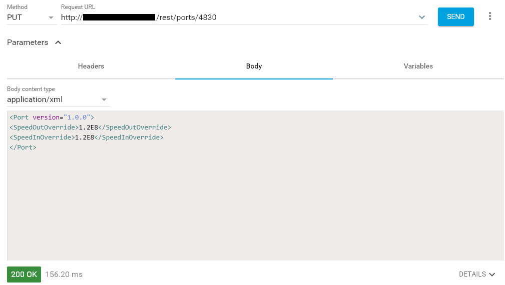

From this request, I was able to obtain the ID for my selected interface, FastEthernet0/0.  This ID is 4830.  Now taking that ID you will issue a PUT with the following details:
Method: PUT
URL: http://daHostname:8581/rest/ports/portID   (If FA DA: http://ProxyHostname:8581/rest/ports/filtered)
Body:
<Port version="1.0.0">
<SpeedOutOverride>1.2E8</SpeedOutOverride>
<SpeedInOverride>1.2E8</SpeedInOverride>
</Port>

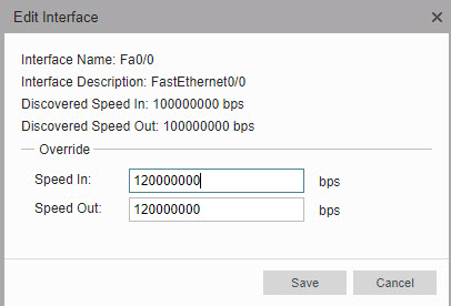

In the example we are Overriding the speed to set a speed of 120000000 bps (120 Mbps) instead of the discovered 100000000 bps (100 Mbps):
You can check the results in the NetOps Portal by going to Administration -> Monitored Devices -> Find the original Device -> Polled Metric Families tab.  Then click in the white space next to the Interface Metric Family and the Interface components will display at the bottom.  Take note of the triangles to the top left of the Speed In and Out column entries for the modified device.  This signifies the discovered speed has been overridden.
And if you right-click that interface and click edit:
