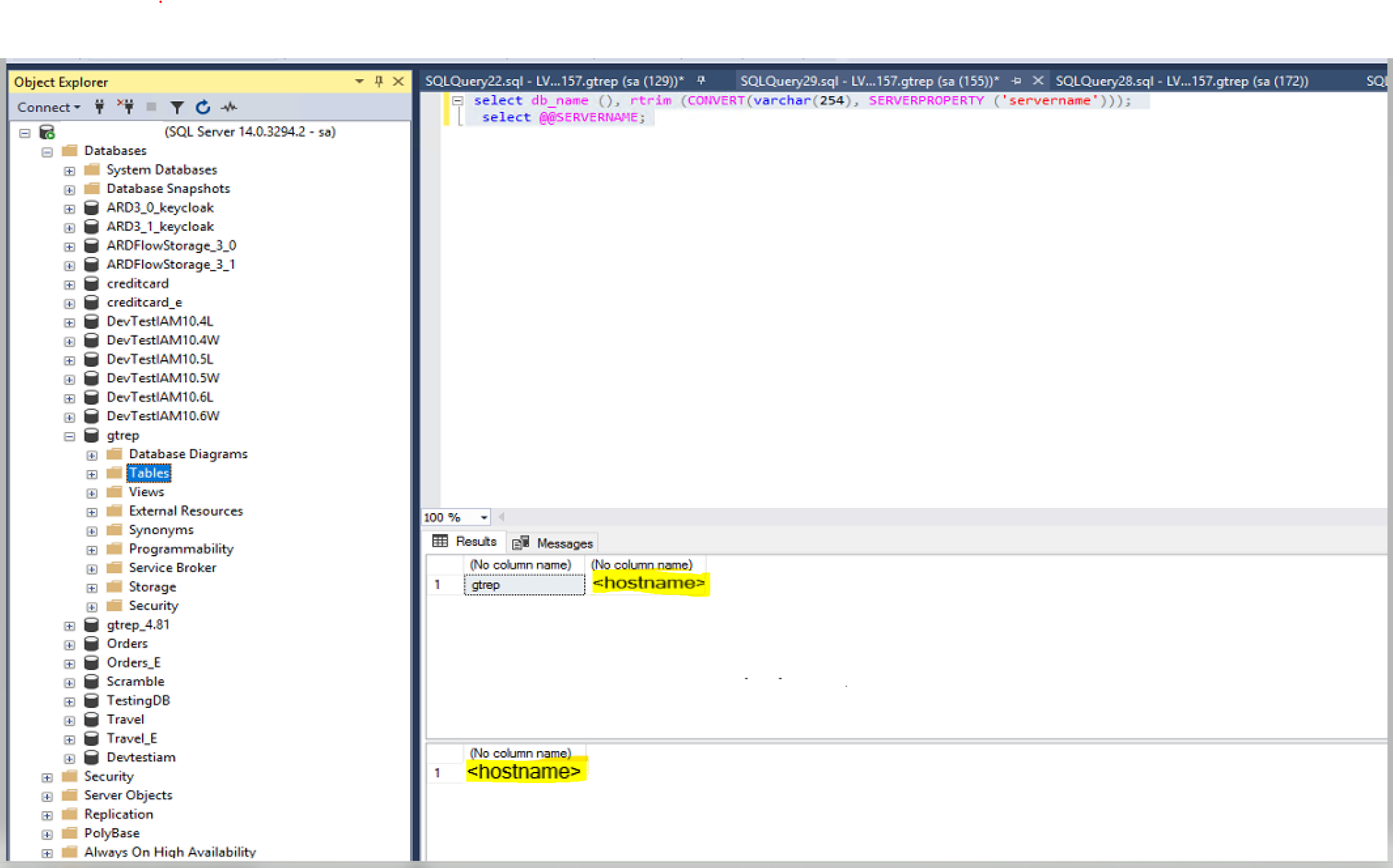

To correct the Server name used by the SQL Server, you need to contact your SQL Server DBA. They can run the following SQL queries to verify the values returned by the error.
select db_name (), rtrim (CONVERT(varchar(254), SERVERPROPERTY ('servername')));
select @@SERVERNAME;
As mentioned above, the two should match. In order to resolve the mismatch, the 'servername' need to be changed in SQL Server to the value of the 'NewServer'.
Your DBA can make the needed change by running the following SQL commands:
exec sp_dropserver 'OldServer';
GO
exec sp_addserver 'NewServer', 'local';
GO
Where, 'OldServer' is the old server name, and 'NewServer' is the new server name.
