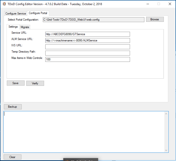

Once the service is running you will need to configure the GTService Layer URL:
1. Select the Configure Portal Tab
2. Modify the Service URL: field and replace <<machinename>> with the TDM Portal Hostname
3. If you are integrating TDM with ALM, you will also want to modify the ALM Service URL field with the hostname of the ALM server.
4. Verify the connection by clicking the Verify button
5. Save the configuration by clicking the Save button.
6. Optional - Click the Backup button to make a Backup copy or the configuration file.

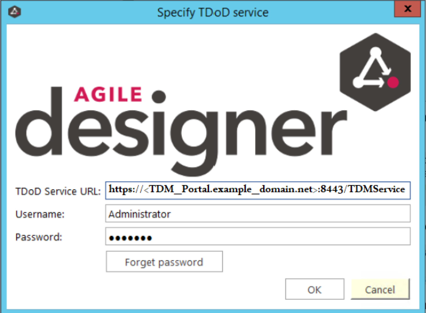

If you are running TDM 4.9, and have TDM Portal version 4.9.53.0 or greater, you can try connecting ARD to the repository using the native TDMService for the TDM Portal. However, you might experience some odd, unexpected behavior. The TDMService has not been certified by the ARD Product Development team, and is not officially supported. If you experience unexpected results while using the TDMService, please install and configure the TDoD (GTService) component and use it for your TDM/ARD integration.
To connect ARD to TDM simply replace the TDoD Service URL, in the Repository Connector, with https://<TDM_Portal_Host>:8443/TDMService. For example:
