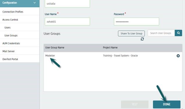

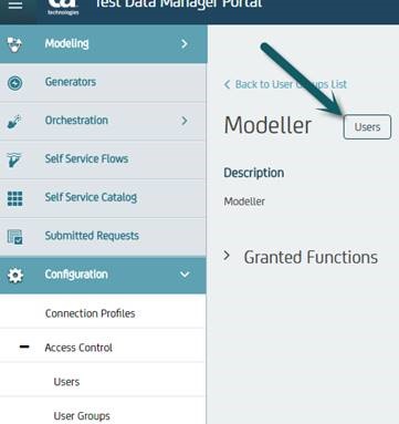

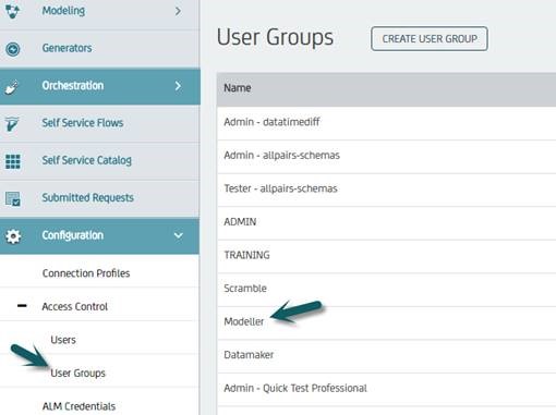

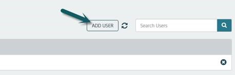

Steps to link a user to a connection profile:
To do that, you should first make sure that the user is part of a group. You then link the connection profile that is being used by the self-service flow to the group or the user.
  1. Add user to a User Group.
  2. Link connection profile to group
