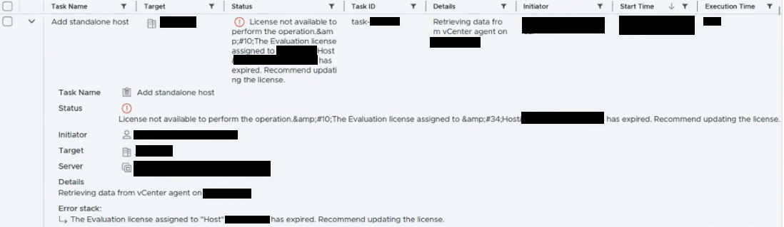

Following an ESXi host upgrade to 9.1, the host experiences licensing failures that prevent standard operations, such as powering on virtual machines.
  • Attempts to disconnect and reconnect the host on the vCenter yields the following error:
    License not available to perform the operation. The Evaluation license assigned to "Host" <ESX_IP> has expired. Recommend updating the license

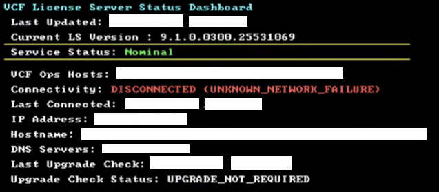

  • The License Server continuously toggles to a Connectivity Disconnected(Unknown_Network_Failure) state, which persists across reboots.

The issue is triggered by underlying network connectivity disruptions between vCenter, VCF Operations, and the License Server infrastructure. Because vCenter cannot reach the License Server to retrieve a valid 9.1 license, it fails over to the host's previous evaluation license. Since this evaluation period has already expired, vCenter fails to add the host
  1. Ensure reliable network communication between vCenter, the License Server, and VCF Operations. To isolate and rule out physical network or routing issues, one of the methods can be temporarily migrating the vCenter, License Server, and Ops VMs to the same ESXi host.
  2. Once the License Server stops flapping and network stability is confirmed, restart the hostd and vpxa services. This forces the agents to re-initialize and rebuild their communication channels with vCenter, clearing the stalled state.
    /etc/init.d/hostd restart
    /etc/init.d/vpxa restart
  3. Right-click the disconnected ESX host in the vCenter inventory and select Connect to add it back into the cluster.
