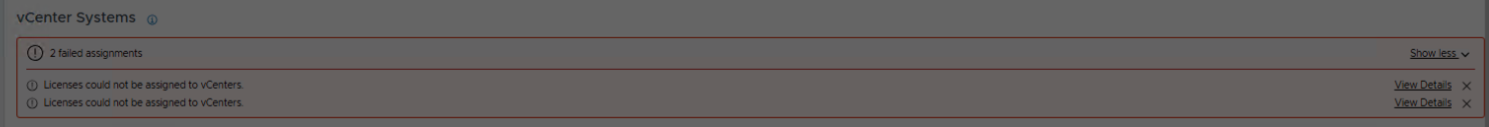

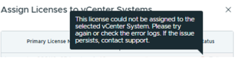

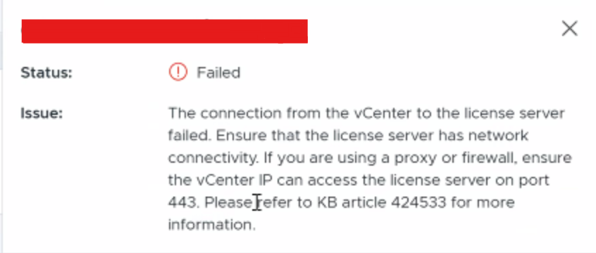

  • License assignment to a selected vCenter in VCF Operations 9.1 fails with an error message "failed assignments" and "Licenses could not be assigned to the selected vCenter".
  • Selecting the View Details tab for the error message shows the message below:
    This license could not be assigned to the selected vCenter system. Check the network connection between the license server and the selected vCenter system and try again.
    This license could not be assigned to the selected vCenter system. vCenter is not able to resolve the hostname of license server.
  • An error message may show on the licenses page saying: “Licenses could not be synchronized with vCenters.” or  “Add-on licenses could not be synchronized with vCenters.”

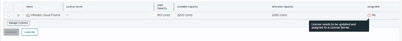

  • Navigating to VCF Operations UI > Manage > Licensing > Licenses and Registration > VCF License shows Assignable as NO with error message as "License needs to be updated and assigned to the license server"

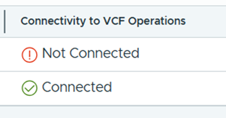

  2. Under Registration and License Server Status, click Manage > License Servers to inspect the Connectivity to VCF Operations column.
    • Note: The status may falsely display as connected in this user interface if the Licensing Server vApp was deployed with a valid IP address but possesses missing or invalid DNS records.

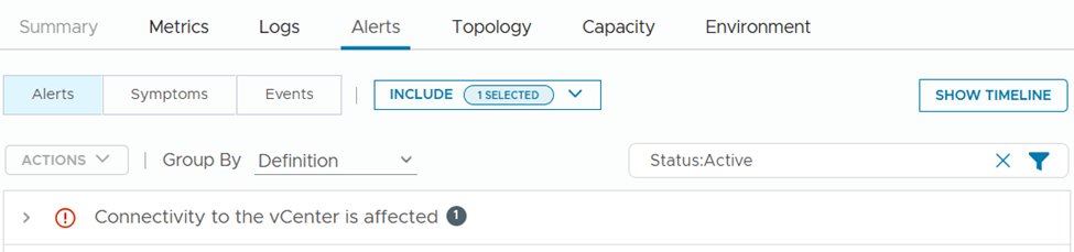

  1. In VCF Operations, navigate to Operate > Inventory, select the specific vCenter targeted for license assignment, and select the Alerts tab.
    • Verify if an alert reading Connectivity to the vCenter is affected is present, confirming an active communication block via the user interface.

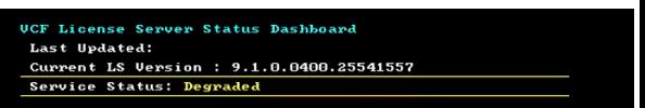

Check License Server Health and Expand Storage
  1. In VCF Operations, navigate to Operate > Dashboards > All > License Server Health.
  2. Select the target license server to review CPU, memory, and disk utilization.
  3. If CPU or memory utilization permanently exceeds 90%, reboot the appliance from the vSphere Client by navigating to the VM and selecting Actions > Power > Reset.
  4. If a disk partition (root or data disk) is full, expand the virtual hardware storage allocation:
    • Gracefully shut down the guest operating system of the license server VM (Actions > Power > Shut Down Guest OS).
    • Right-click the VM and select Edit Settings.
    • Expand the full Hard Disk entry, increase the provisioned size, and click OK.
    • Power on the virtual machine (Actions > Power > Power On). The appliance automatically resizes the partition during the boot process.

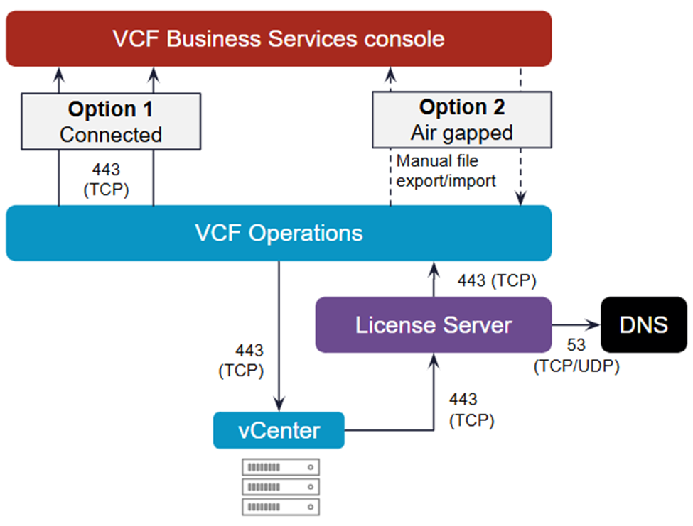

Connectivity diagram between License Server and other components:

License server is expected to get time from the ESXi hosting it. However it may incorrectly attempt to connect to an external NTP server to update its internal clock per following release note:
https://techdocs.broadcom.com/us/en/vmware-cis/vcf/vcf-9-0-and-later/9-1/release-notes/patch-releases-9-1-0-x/vcf-operations/9-1-0-0400/vcfoperations-9-1-0-0400-release-notes.html
  • License server attempts to connect to external Network Time Protocol (NTP) servers for time synchronization
    The license server incorrectly attempts to connect to an external NTP server to update its internal clock.
    Starting with VCF Operations 9.1.0.0400, time synchronization for the license server is restricted exclusively to the host system on which the license server virtual machine runs.
