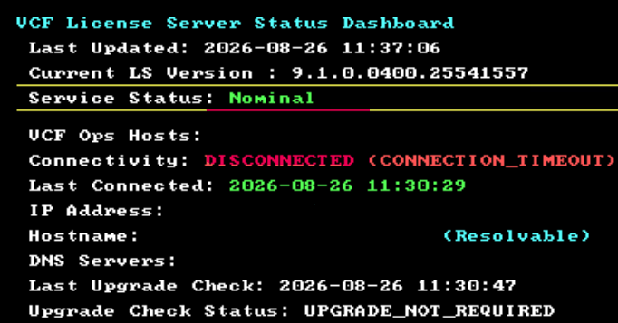

  • Attempts to attach a VCF Operations license to a vCenter Server fail.
  • The License Server reports a "nominal" state and shows as disconnected within the VCF Operations (VCF-O) UI.
  • Basic network connectivity from the vCenter Server shell to the License Server appears functional (ping and nslookup succeed).
  • Stateful TCP connections from the vCenter Server to the License Server fail. Running curl -kv https://<license_server_ip> or attempting an openssl connection on port 443 results in dropped packets, connection timeouts, or connection refused errors.
