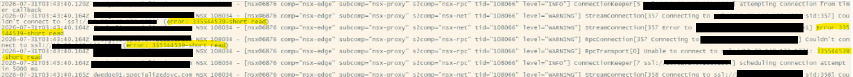

  • Log analysis on the Transport Node reveals communication errors such as: error: 335544539-short read.
