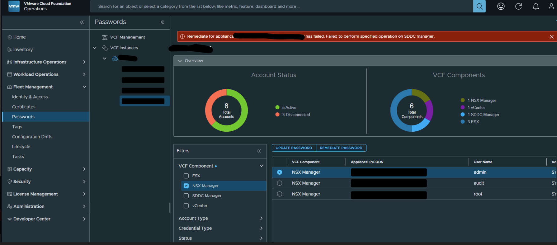

Unable to remediate passwords for the NSX accounts in VCF Operation UI due to error "Remediate for appliance <FQDN>has failed. Failed to perform specified operation on SDDC manager".

  • On remediating NSX user credentials within VCF operation UI, the below error is observed:
    "Remediate for appliance <FQDN> has failed. Failed to perform specified operation on SDDC manager"
