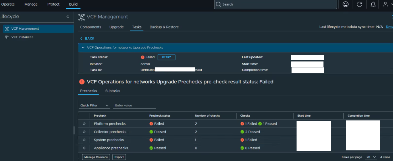

  • VCF Operation VCF management  Tasks on  GUI shows error message for platform prechecks:
    VCF Operations for networks Upgrade Prechecks pre-check result status: Failed
    Reference screenshot as below:

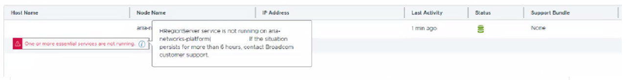

  • On VCF Operations for Networks GUI platform shows below error:
    HRegionServer service is not running on aria-networks-platform(##.###.###.##). If the situation persists for more than 6 hours
    Reference screenshot:
