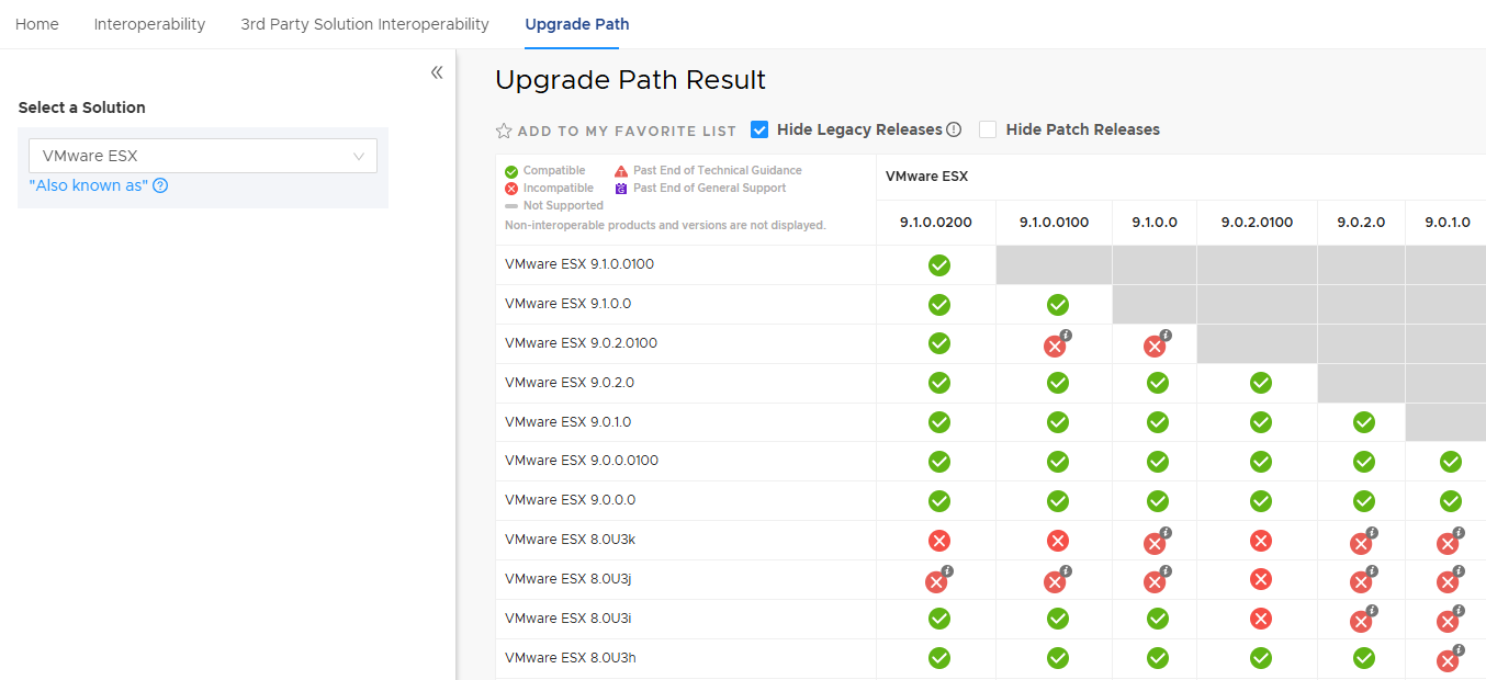

  • ESXi host upgraded to newer build and would like to rollback to previous build to address a upgrade blocker.
Example: The hosts running on ESXi 8.0 U3i upgraded to to 8.0 U3k. Upgrade from 8.0 U3k to 9.1.0.0. is not a supported path. Refer the screenshot.
