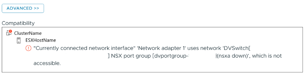

Connectivity issues occur where virtual machines (VMs) lose tags and Distributed Firewall (DFW) rules fail to apply, often resulting in vMotion failures. This behavior is linked to a configuration hash mismatch in the Management Plane Agent (MPA) communication between the NSX Manager nodes and ESXi hosts.
  • vMotion fails with:
  • On affected host's in /var/run/log/nsx-syslog.log, the following configuration hash mismatch error is observed, indicating a discovery loop on the ESXi host:
