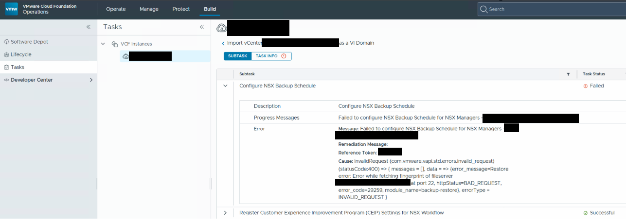

The following error was observed on the Configure NSX Backup Schedule subtask of a brownfield import:
Error: Failed to configure NSX Backup Schedule for NSX Managers
Cause: InvalidRequest (com.vmware.vapi.std.errors.invalid_request) (statusCode:400) => { messages =[], data ==> {error_message=Restore error: Error while fetching fingerprint of fileserver <fileserver> at port <port>, httpStatus=BAD_REQUEST, error_code=29259, module_name=backup-restore}, errorType = INVALID_REQUEST }

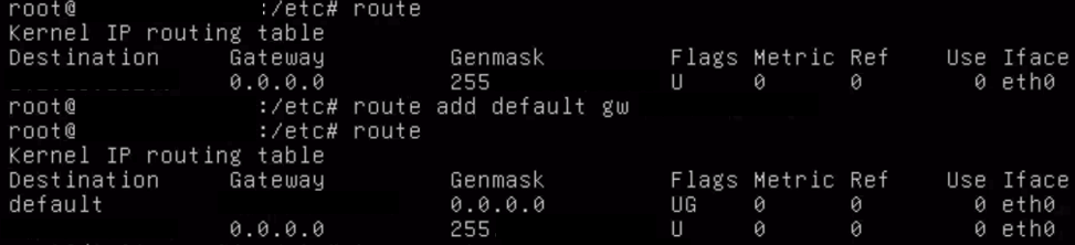

  3. View the routing table: The route command did not show a default gateway
  4. Add the default gateway: (route add default gw <gateway_ip>)
  5. Test connectivity: traceroute and ping to the backup server are successful

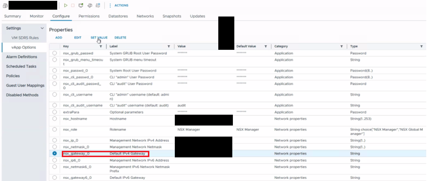

  7. Further analysis: The NSX Manager VM's vApp Properties showed values that were obtained from the incorrect deployment.
