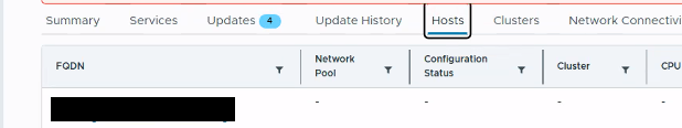

  • The host is showing -- status on the SDDC Manager UI
  • Upgrade starts and immediately fails with following error - System initiated upgrade cancel operation
