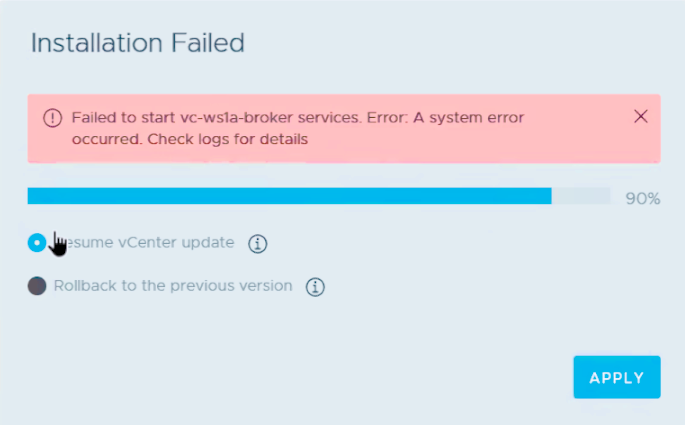

"Failed to start vc-ws1a-broker services. Error: A system error occurred." when patching vCenter
Article ID: 450877
VMware vCenter Server
When attempting to patch vCenter Server 8.x, the process fails at 90% because the vc-ws1a-broker service fails to start. This issue occurs after running the vCenter 9 RDU upgrade precheck if the upgrade process is not completed.
