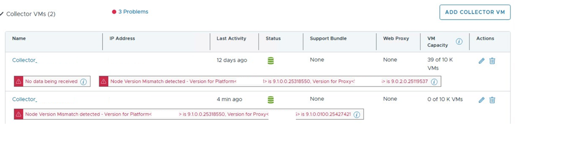

  • The VMware Cloud Foundation (VCF) 9.1 upgrade for the management vCenter stalls due to a Node version mismatch error within VCF Operations for Networks.
  • Error message see is:
    Node Version Mismatch detected - Version for Platform<##.##.###.##> is 9.1.0.0.25318550, Version for Proxy<##.##.###.##> is 9.0.2.0.25119537
  • This occurs when platform nodes are upgraded to VCF 9.1 General Availability (GA), but a collector node is either offline or replaced with a version running Express Patch 1 binaries, preventing cluster synchronization.
  • VCF Operations administrative interface fails to display active collectors.
  • Synchronization and inter-node communication failures occur within the cluster.
  • The patch version manifest (cat build-target/deployment/patch.txt) on the platform and collector node indicates build version 9.1.0.0100.25427421 (Express Patch 1), while platform nodes are on the 9.1 GA release.
    See screenshot showing the error on the collector node.
