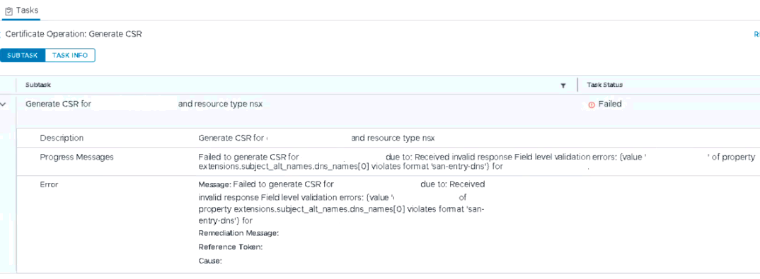

  • SDDC Manager certificate replacement tasks may fail during CSR generation or validation phases or during a certificate import task.
    • Example of Certificate Operation: Generate CSR subtask failure:
      Description
      Generate CSR for ####FQDN#### and resource type nsx
      Progress MessagesFailed to generate CSR for ####FQDN#### due to: Received invalid response Field level validation errors: {value '####FQDN####' of property extensions.subject_alt_names.dns_names[0] violates format 'san-entry-dns' for ####FQDN####
      Error
      Message: Failed to generate CSR for ####FQDN#### due to: Received invalid response Field level validation errors  ####shortname####' of property extensions.subject_alt_names.dns_names [0] violates format 'san-entry-dns' for ####FQDN####
      Remediation Message:
      Reference Token:
      Cause:
