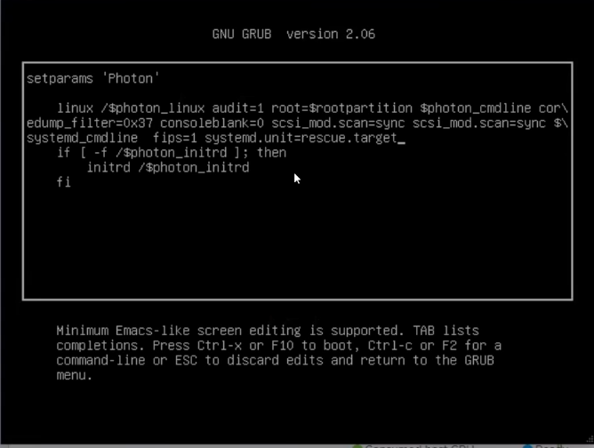

- After the VCSA Photon OS starts, press the e key to enter the GNU GRUB Edit Menu.
- Locate the line that begins with the word "Linux".
- Append these entries to the end of the line -
systemd.unit=rescue.target
- Press the

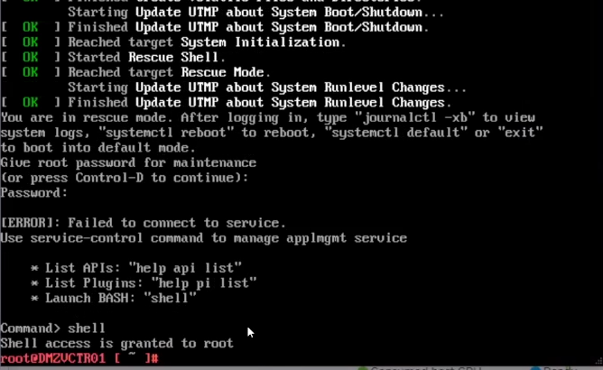

F10 key to continue booting. - When prompted, enter the root password. After successful authentication, access to the Bash shell will be restored.
- To verify the services are not starting run
service-control --status --all. - To verify whether any certificates have expired, run the following command. Alternatively, if the VMware vCert tool is already installed on the vCenter Server Appliance, you can use it to perform a comprehensive certificate health check.

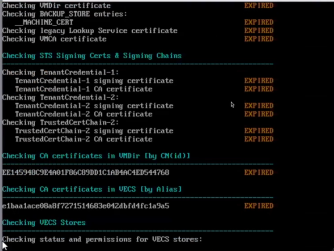

In this example, vCert was used with Option 1 – "Check Current Certificate Status". The resulting report showed that the majority of the vCenter certificates had expired.

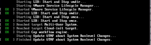

- Note: In this case, the screen turned black with a blinking cursor as the system continued to start parts of the system. It will return to the vCert screen.
- At this point, you should have the ability to SSH into the vcenter.

- It's possible to still have expired certificates in "Checking CA certificates in VMdir" and "Checking CA certificates in VMdir"
- Use option 3 to manage certificates
- Then use option 3 "CA certificate in VMware directory"
- Review the certificates and find the ones that are expired, then press option 2 " remove CA certificates from VMware directory"
- When prompted, enter the number corresponding to the certificate you want to remove.
- Go back to the main menu and select option 1, " check current certificate status," to confirm that all certificates that need to be renewed have been renewed.
