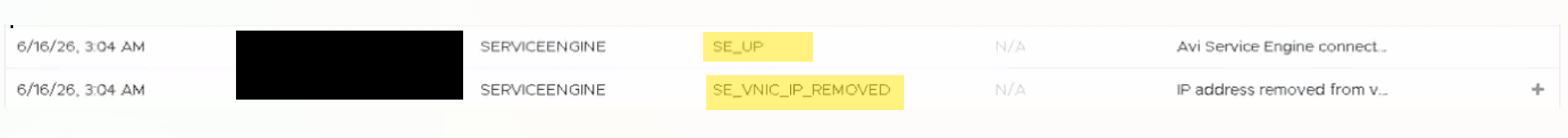

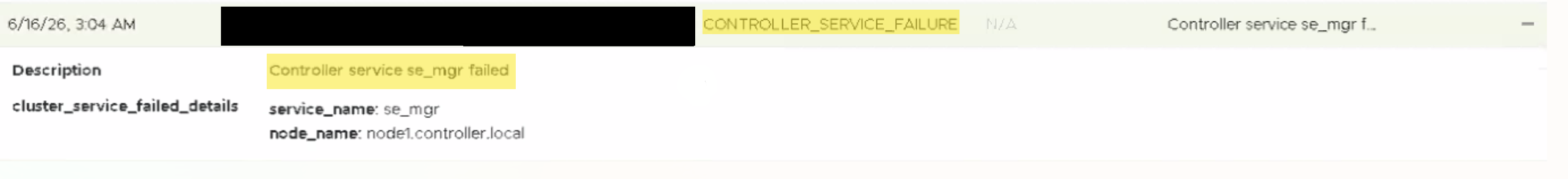

  • If the underlying host fails to provide adequate CPU and memory resources to the Controller—leading to a se_mgr process crash—the Controller may inadvertently issue a delete API call, removing the configured static IP from the SE.
  • Below events can be seen on the controller for the same time period: Operations > Events > All Events

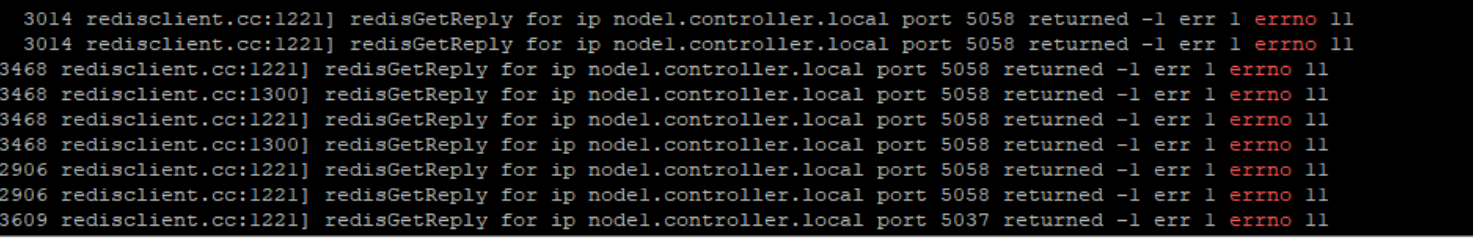

  • Below redis errors can be seen in the se_mgr logs > /var/lib/avi/log/glog

  • This behavior can occur due to transient Redis performance degradation driven by systemic CPU and resource constraints. When the underlying environment experiences heavy CPU contention:
    • The Redis server may suffer latency and return errors to calling processes (se_mgr, resmgr).
    • Redis access timeouts and lock acquisition failures can trigger unexpected service bail-outs, process restarts, or temporary recreation of Service Engine objects in memory.
    • Due to these processing delays and lock failures, the Controller's synchronization logic may fail to correctly re-apply the static IP upon SE reconnection.
