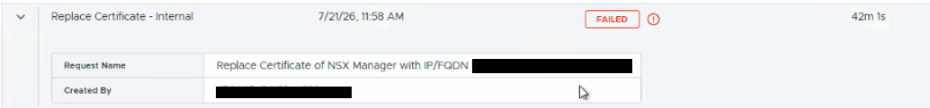

  • A certificate was created in VCF Ops Fleet Management that contains Subject Alternative Names (SANs) for multiple components, such as the NSX VIP as well as each of the NSX Managers.
  • The certificate was successfully applied to one component, such as the NSX VIP.
  • Attempts to perform a certificate replacement operation for additional components, such as the individual NSX Manager nodes, fails with the following error;
Error Code: certificate.upload.error
 Certificate task REPLACE_CERTIFICATE for <NSX-Manager-FQDN> has failed. Error message: Unable to upload certificate against CSR ID fba6e568-####-####-####-75d209eab46e on NSX for replace certificate operation with error message : Private key does not match with the certificate.. Please check VIM adapter logs and task status for more details.
