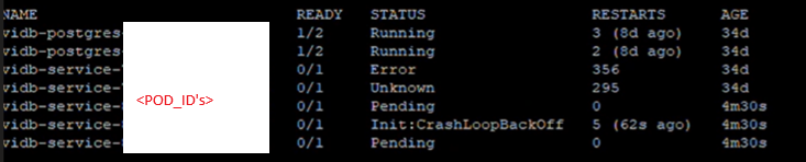

  • Execution of kubectl -n vidb-external get pods reveals several pods in CrashLoopBackOff and error states.

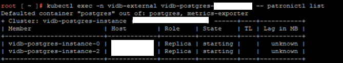

  • Execution of kubectl exec <PostgresPodName> -n prelude -- patronictl list confirms that the leader node is lost and pods are stuck in 'starting' state

The deadlock is caused by the Kubernetes OrderedReady policy, which refuses to replace the missing leader pod because surviving replicas are permanently stuck in a NotReady state (due to missing WAL archives). This prevents any new Patroni leader election.
