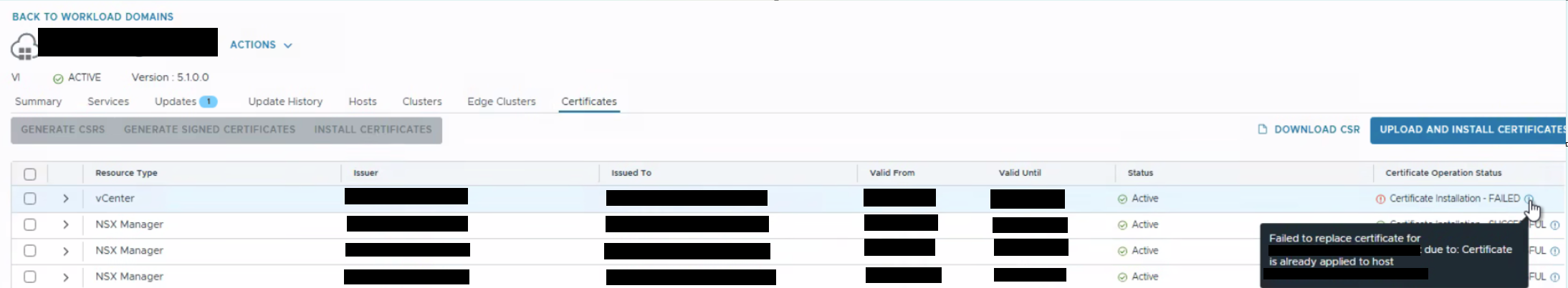

  • Despite the task failure, the vCenter certificate is valid and successfully installed, displaying an "Active" status with valid From and Until dates, as illustrated in the image below.
  • To verify, navigate to SDDC Workload Domains > Select the specific workload domain > Certificates > Select the vCenter under Resource Type colulmn.

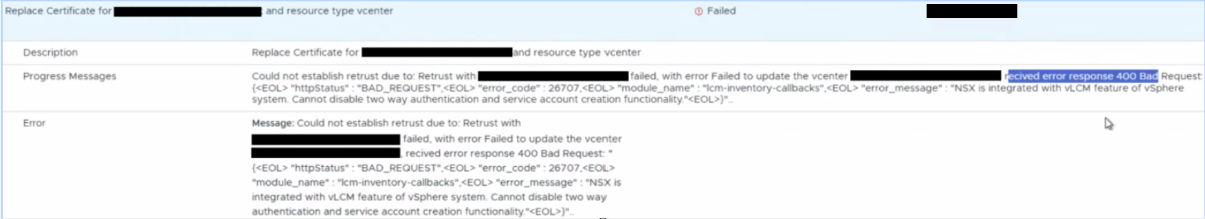

  • Although the certificate is successfully installed on the vCenter Server, the trust relationship between NSX and vCenter is broken, causing the SDDC Manager task to fail and display Error code 26707: "NSX is integrated with vLCM feature of vSphere system. Cannot disable two way authentication and service account creation functionality." as shown in the image below.
