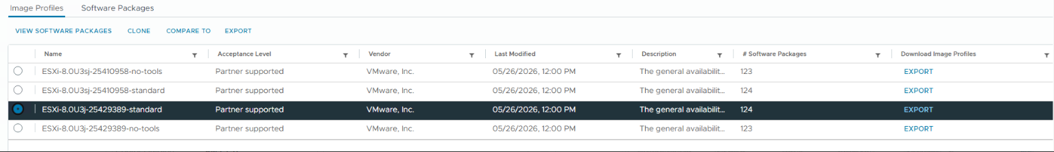

  3. Import the offline bundle VMware-ESXi-8.0U3j-25429389-depot.zip to Image Builder, refer Import a Software Depot.

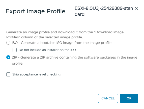

  4. Export the required Image Profile to Offline Bundle Zip file, refer Export an Image Profile to ISO or Offline Bundle ZIP.
    1. Select the Image "ESXi-8.0U3j-25429389-standard" to update the host to 8.0 U3j.
    2. Select ZIP as the option.
    3. Download the bundle by clicking on DOWNLOAD button.
  5. Use the download image to patch the host which contains only one image profile.
