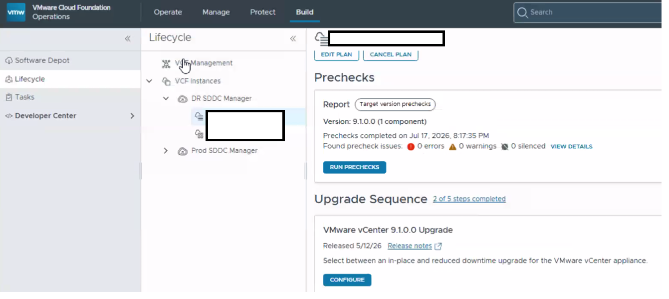

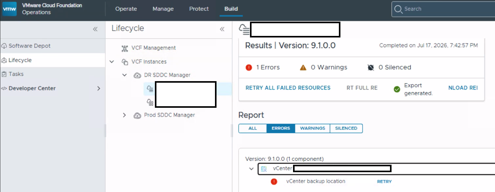

When performing an upgrade pre-check for a VMware Cloud Foundation (VCF) vCenter instance upgrade to version 9.1, the validation fails with the following error:
ERROR, VCManager, <vcenter>, vCenter backup location, VALIDATION_FAILED, High: Do not perform upgrade without addressing this issue., vcenter-base-backup-not-on-sddch mgr, CRITICAL, false, VManager, Check Center backup is nat located on SDDC Manager, ERROR, venter backup should not be located on SDDC Manager, "["message': Please reconfigure venter backup to use another location"", ""link"": *"")]", High: Do not perform upgrade without addressing this issue.
