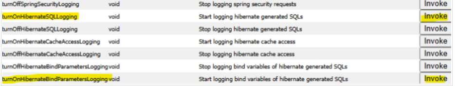

To find the cause why JMX removeProcessRun operation could not remove the process some logs in SQL trace are needed :
  1. Open JMX page
    http://nac_server_name:20203/mbean?objectname=Logging%3Atype%3DLog4j
    Replace nac_server_name by the name of NAC server
    Default login / password is nolio/nolio
  2. Click Invoke button for "turnOnHibernateSQLLogging" and "turnOnHibernateBindParameterLogging"
  3. Try again to remove the job using JMX removeProcessRun
  4. Collect the logs <RA_HOME>/logs/nolio_dm_all*.log of NAC and open a case at Broadcom Support with these logs.
  5. invoke this to disable SQL Logging :
    "turnOffHibernateSQLLogging" and "turnOffHibernateBindParameterLogging"
    as these logging settings generate a lot of extra logs and could affect the Nolio performance.
