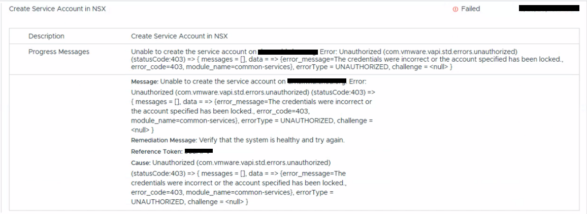

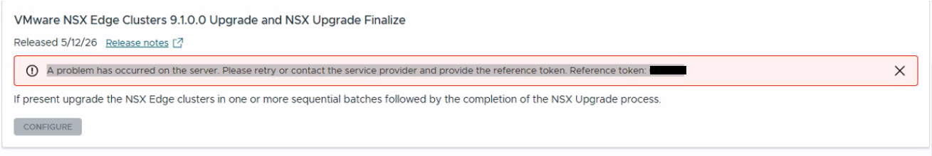

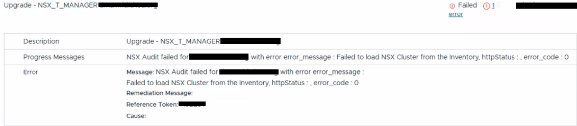

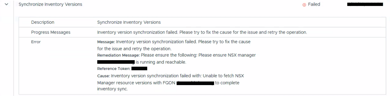

Error: A problem has occurred on the server. Please retry or contact the service provider and provide the reference tokenError: Unable to create the service account on <NSX_FQDN>. Error: Unauthorized (com.vmware.vapi.std.errors.unauthorized) (statusCode:403) => { messages = [], data = => {error_message=The credentials were incorrect or the account specified has been locked., error_code=403, module_name=common-services}, errorType = UNAUTHORIZED, challenge = <null> }Error: NSX Audit failed for <NSX_FQDN> with error error_message :Failed to load NSX Cluster from the Inventory, httpStatus : , error_code : 0VMware Cloud Foundation (VCF) 9.1
This issue is caused by an out-of-band authentication mismatch. The admin, root, and audit passwords were updated locally on the NSX Manager appliance, causing them to fall out of sync with the credential store. Because VCF Operations continuously polls the NSX Manager using the stale credentials, it triggers an account lockout resulting in a 403 Unauthorized error.

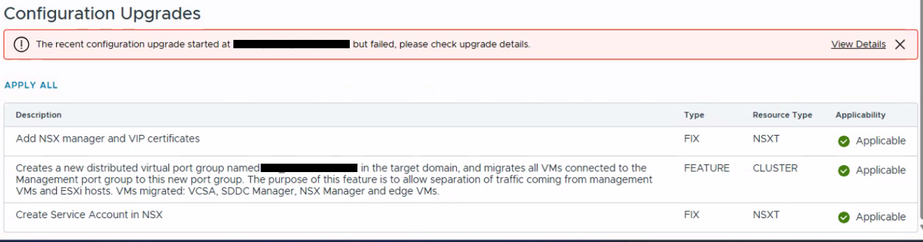

Execute the "Apply All" action under Configuration Upgrades, which will successfully provision the required service account.

Retry the NSX upgrade once the service account is created and API access is fully restored.
