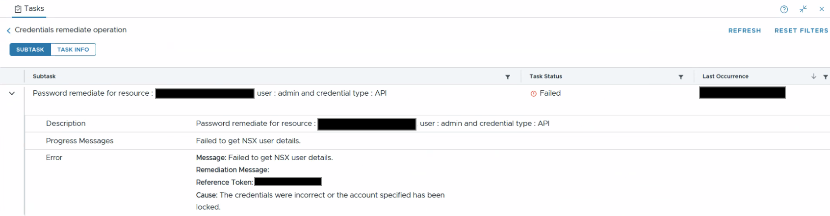

This article helps troubleshoot failed credential operations with NSX-T Components. When attempting to rotate, update, or remediate a password for an NSX 4.x or NSX-T component in the SDDC Manager UI, the following error is observed:
"Password management operation failed"

Failed to get NSX user details error can be seen in Password Management while remediating the NSX-T Manager Admin user password :

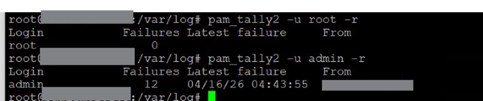

  7. Verify the accounts are not locked out with pam_tally2 or faillock
        For VCF versions 4.3.0.0 up till 5.0.0.1, use:
    pam_tally2 -u root -r
    pam_tally2 -u admin -r
    pam_tally2 -u audit -r
        For VCF versions starting from VCF 5.1.0.0, use:
        /usr/sbin/faillock --user root --reset
    /usr/sbin/faillock --user admin --reset
    /usr/sbin/faillock --user audit --reset
