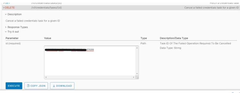

    3. If the UI option is unavailable, use the API Explorer:
      1. Navigate to Developer Center > API Explorer > APIs for Managing Credentials.
      2. Locate DELETE /v1/credentials/tasks/{id}.
      3. Enter the UUID of the failed task and click Execute.
