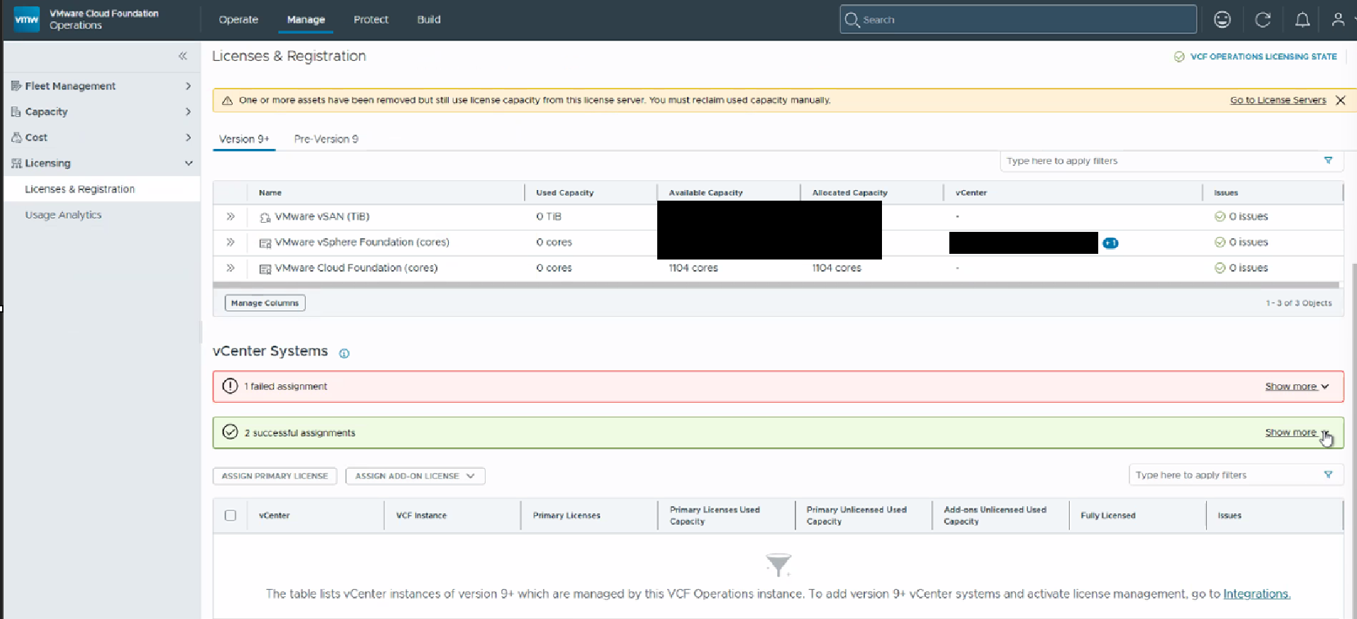

  • After upgrading vCenter Server from version 8.0 to 9.1, it cannot be licensed on VCF Operations. The vCenter Server does not appear under the vCenter Systems under Manage > License & Registrations tab and the following warning appears "One or more assets have been removed but still use license capacity for this license server. You must reclaim used capacity manually":
  • The vCenter Server was previously licensed for version 9.0, rolled back to version 8.0, and then upgraded to version 9.1.

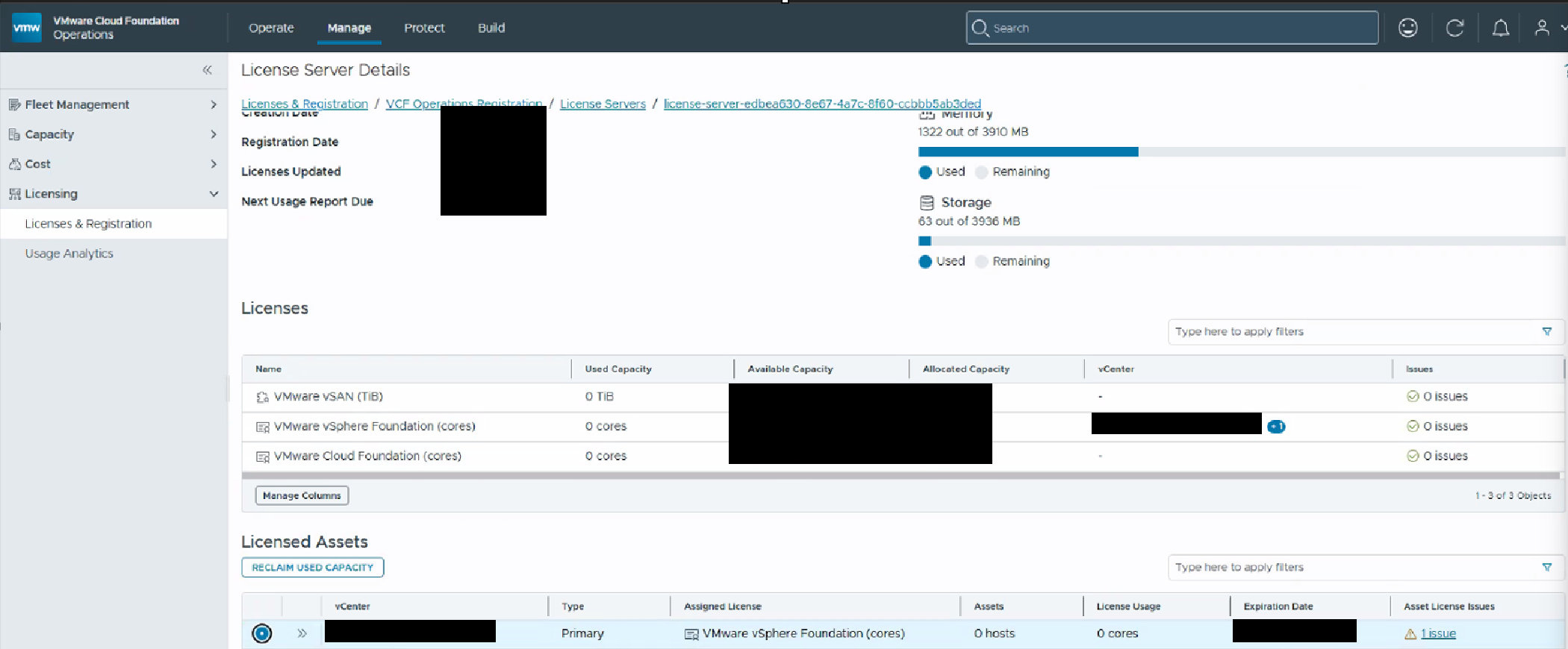

  • Entity of vCenter Server from version 9.0 still appears under the License Server Details and is using the capacity:

Step 1: Reclaim Used Capacity:
  1. Log in to the VCF Operations UI.

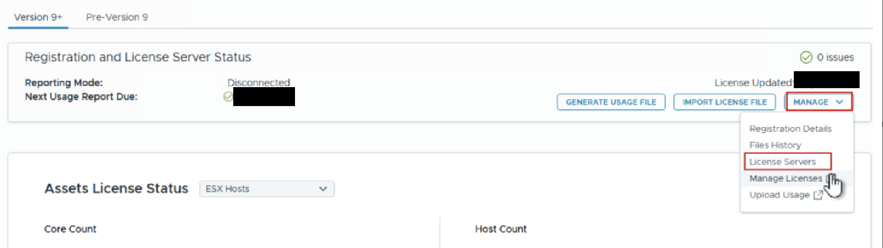

  2. Navigate to Manage > Licensing > Licenses & Registrations > Manage > License Servers.
  3. Click on the relevant License Server.
  4. Scroll down to Licensed Assets, select the affected vCenter Server, and click Reclaim Used Capacity.
