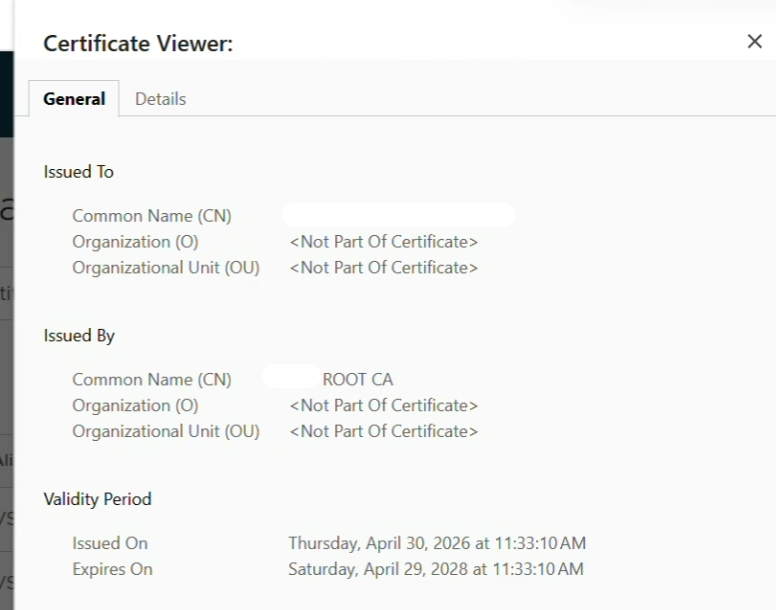

  • Validating web certificate shows its updated from browser but internal certs are not getting updated
  • Validating the expiry date by running the below command shows that current internal certificate is expired
    echo "" | keytool -list -keystore /usr/lib/loginsight/application/etc/3rd_config/keystore -rfc 2> /dev/null | openssl x509 -noout -enddate
