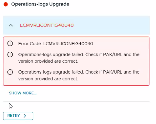

The upgrade task for VCF Operations for Logs 9.0.x triggered from VCF Operations (Lifecycle) / VCF Fleet Management UI fails with the error:
LCMVRLICONFIG40040
Operations-logs upgrade failed. Check if PAK/URL and the version provided are correct
