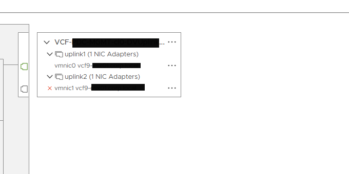

  • vmnic is disconnected on vCenter.
  • The link status of vmnic is marked down. However, the admin status remains up.
    • The "Link Status" column specifies the status of the link between the physical network adapter vmnic# and the physical switch port.
  • ESXi displays old details of firmware and driver of the affected vmnic.
