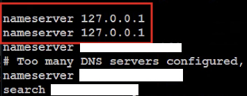

    2. Check for duplicate nameserver 127.0.0.1 entries in the /etc/resolv.conf file:
      cat /etc/resolv.conf
      Example output:
    3. If duplicates exist, remove one entry using following steps:
      • Create a backup: cp /etc/resolv.conf /root/resolv.conf.bak
      • Edit the file: vi /etc/resolv.conf
      • Delete the duplicate line, then save and exit (Esc + :wq!).

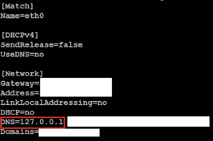

    4. Check the /etc/systemd/network/10-eth0.network file for an additional DNS=127.0.0.1 entry:
      cat /etc/systemd/network/10-eth0.network
      Example output:
    5. If the entry is present, remove it using following steps:
      • Create a backup: cp /etc/systemd/network/10-eth0.network /root/10-eth0.network.bak
      • Edit the file: vi /etc/systemd/network/10-eth0.network
      • Delete the 127.0.0.1 entry, then save and exit (Esc + :wq!).
    6. Restart the network service to apply changes:
      systemctl restart systemd-networkd
