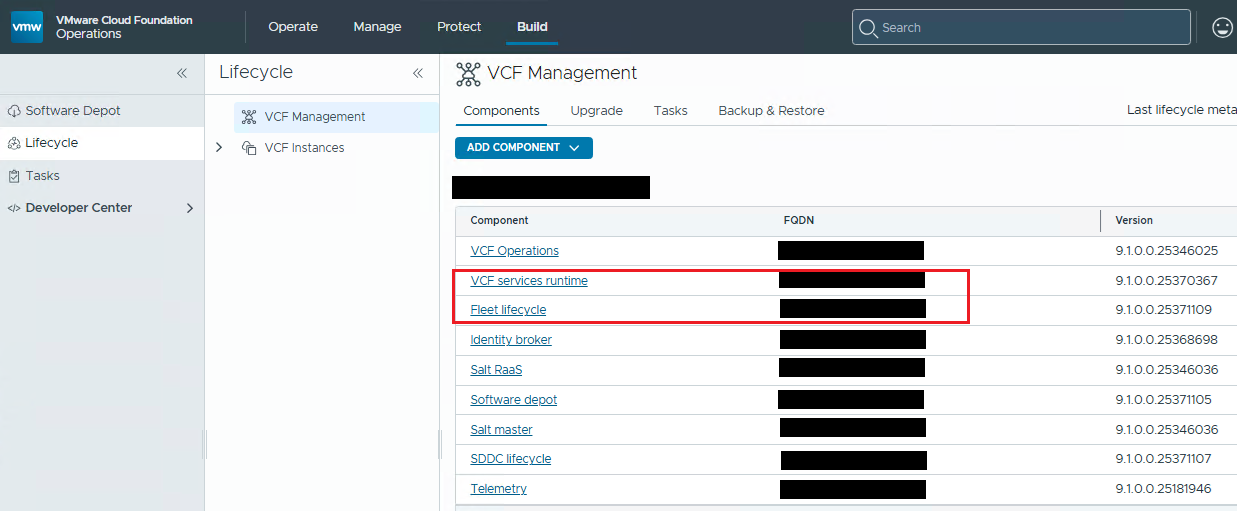

  • Replace placeholder FQDNs such as <fleet-lcm-fqdn> with actual values. Retrieve values from the VCF Operations UI -> Build -> Lifecycle -> VCF Management -> Components (e.g. vsp.example.com for <vcf-services-runtime-fqdn>).
