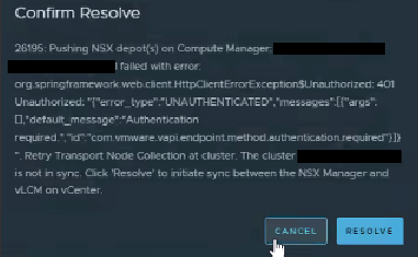

When attempting to apply transport node profile to an NSX prepared cluster that is enabled with vSphere Lifecycle Manager (vLCM), the process may fail with the following symptoms:

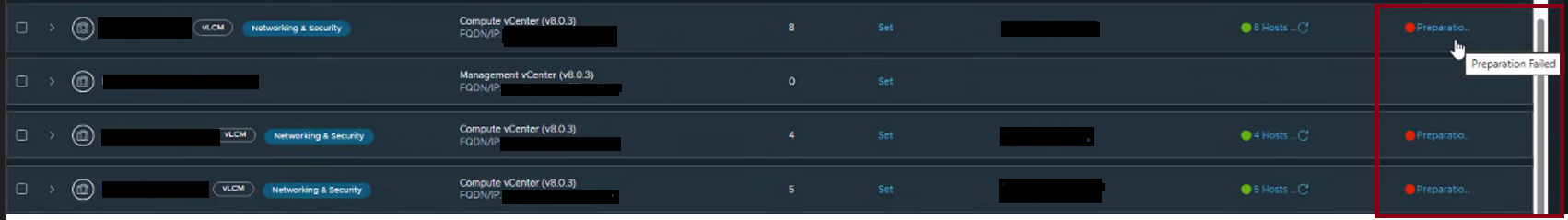

  • The cluster status in NSX Manager shows as Preparation Failed.
  • The error message indicates: Pushing NSX depot(s) on Compute Manager failed with error: org.springframework.web.client.HttpClientErrorException$Unauthorized: 401 Unauthorized.
  • Clicking the Resolve button on the cluster does not initiate a sync.

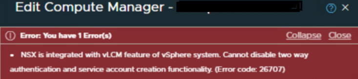

  • Attempting to toggle Enable Trust or Create Service Account in the Compute Manager settings results in: NSX is integrated with vLCM feature of vSphere system. Cannot disable two way authentication and service account creation functionality. (Error code: 26707).
VMware NSX
This issue occurs because Enable Trust and Create Service Account are mandatory security configurations for NSX integration with vLCM. The "Unauthorized" error typically stems from an authentication drift or stale credentials between the NSX Manager and the vCenter Server, preventing the automated deployment of NSX components.
