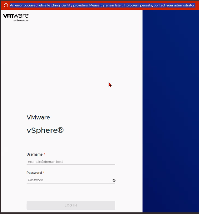

  • Authentication to the vCenter Server (VCSA) using domain account fails with the error message:
An error occurred while fetching the identity provider.
  • The following banner is visible on the VCSA UI login screen :
The identity provider is not configured on the VCF Operations Appliance during the management component import process.
