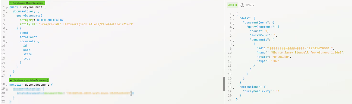

Remove the incorrectly named Stemcell file from Hub using the GraphQL Altair interface
    1. Access Hub GraphQL API on web browser: https://<HUB_FQDN>/hub/altair (use this KB on how to access if needed).
    2. After entering the Raw Token from the Hub GUI, use the following two queries to gather the document ID (this can be found in the download-content-result.yml file you used to manually download the Stemcell), then use the resulting document ID in the delete query to delete the document:
      query QueryDocument {
          documentQuery {
              queryDocuments(
                  category: BUILD_ARTIFACTS
                  entityIds: "vrn/provider:Tanzu/origin:Platform/ReleaseFile:<FILE_ID_FROM_download-content-result.yml>"
                  count
                  totalCount
                  documents {
                      id
                      name
                      state
                      type
      mutation deleteDocument {
        documentMutation {
          deleteDocuments(documentIds: "<DOCUMENT_ID_FROM_FIRST_QueryDocument_QUERY>")

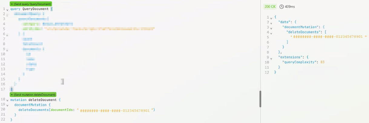

    3. Example for Stemcell that has file ID 231481 in the download-content-result.yml file:
      • QueryDocument query gathering the ID of the document in preparation for deletion:
      • deleteDocument mutation query deleting the document using ID recovered in the QueryDocument query:
