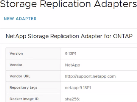

When attempting to add or reload a NetApp Storage Replication Adapter (SRA) in VMware Site Recovery Manager (SRM), the following symptoms may occur:
The SRA adapter fails to load or shows an error state in the SRM UI.
The SRM VAMI page may show the SRA as installed, but the SRM interface cannot discover the storage arrays.
Manual health checks of the SRA management endpoint return an HTTP 404 Not Found error.

VMware Live Site Recovery 9.x
