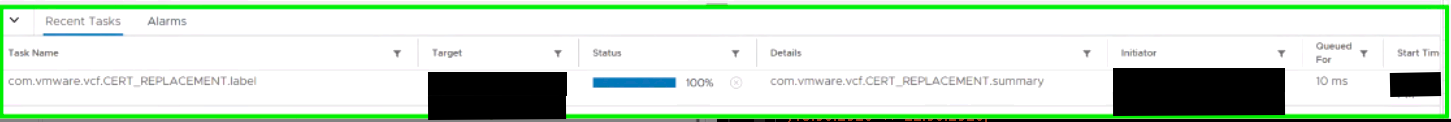

  • Following a certificate replacement operation for fleet components (vCenter, ESXi, SDDC Manager) initiated via Fleet Management, a task i.e.,  "com.vmware.vcf.CERT_REPLACEMENT.label" hangs at 100% within the vCenter Server UI Recent Tasks pane.
  • The initiator of the hung task in vCenter is listed as an SDDC Manager service account
  • Both Fleet and SDDC tasks are completed successfully
  • The task status remains stuck in a running or incomplete state indefinitely, and survives a reboot of vCenter/ SDDC/ Fleet
  • The task itself is successful - i.e.  the underlying Certificate is actually replaced successfully on the component.
  • There is a difference between this scenario and KB https://knowledge.broadcom.com/external/article?articleNumber=433675
  • i.e. the Task name is "com.vmware.vcf.CERT_REPLACEMENT.label" and under Details it states "com.vmware.vcf.CERT_REPLACEMENT.summary"

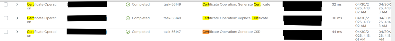

In this case the task name is "Certificate Operation" and under Details it should state "Certificate Operation:<sub-task>" [generate CSR/ generate certificate/ replace certificate]
As an example, a normal, successful task looks like this:

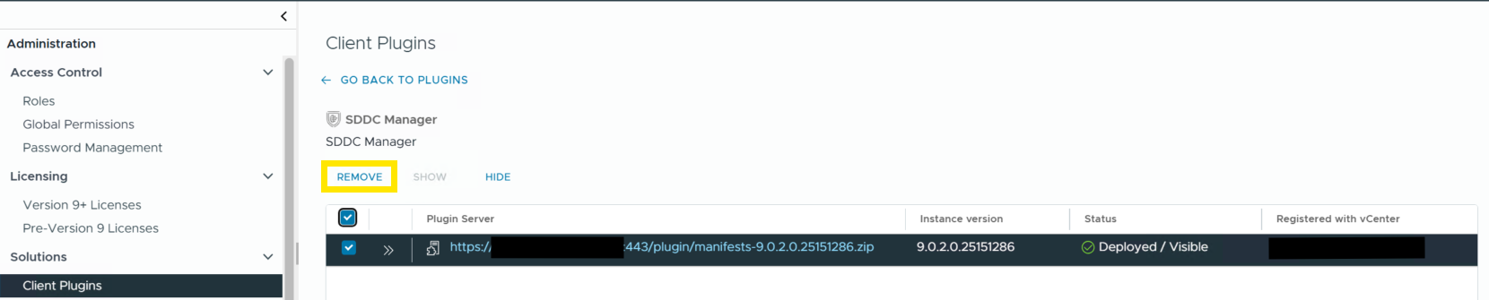

  2. Remove the Plugin from vCenter
    Log in to the vSphere Client as an administrator.
    Navigate to Menu > Administration > Solutions > Client Plugins.
    Locate the SDDC Manager Remote Plugin.
    Select it and click Remove
