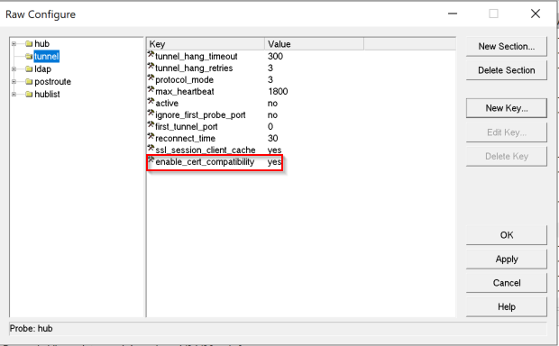

The hub 23.4.7.1 hotfix contains a new key/value pair:  enable_cert_compatibility = yes
This allows the use of SHA1 certificates and should be placed in the <tunnel> section of hub.cfg:
